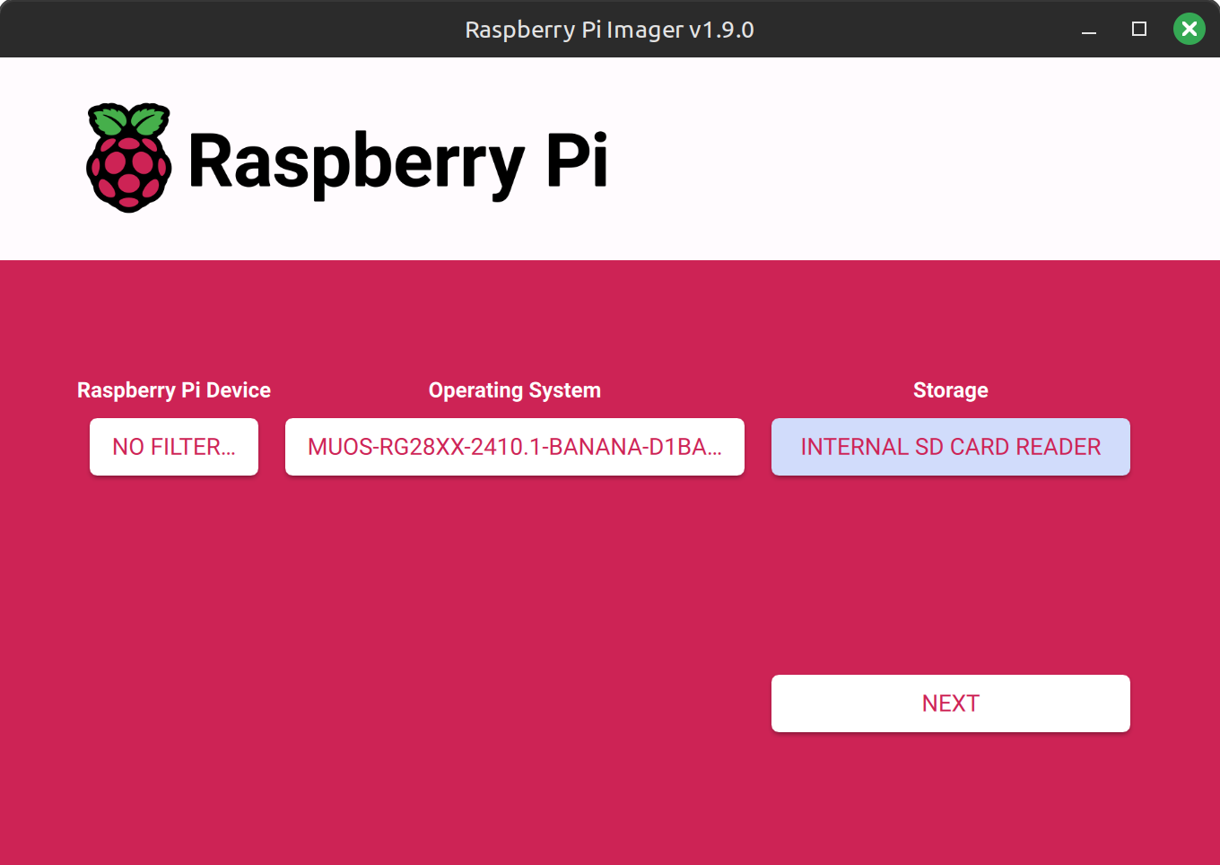

Raspberry Pi Imager
After countless flashes we have determined that the most user friendly tool with the highest chance of success is Raspberry Pi Imager so we’ll focus on that for now.

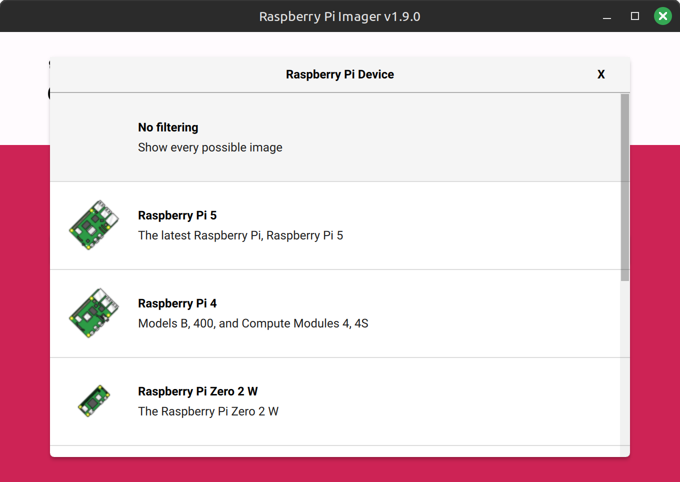

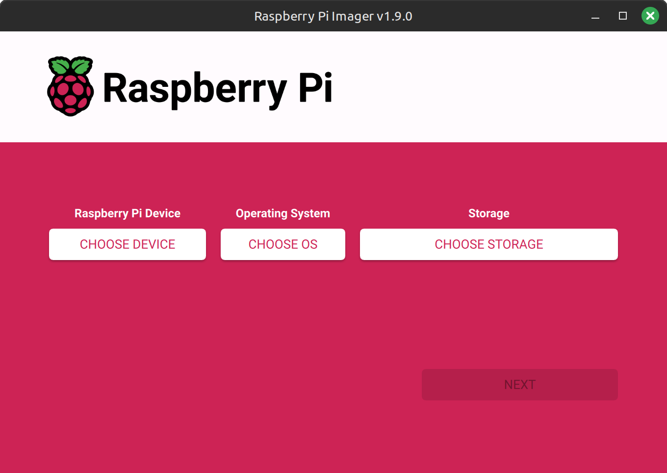

| Choose Device | No Filtering |

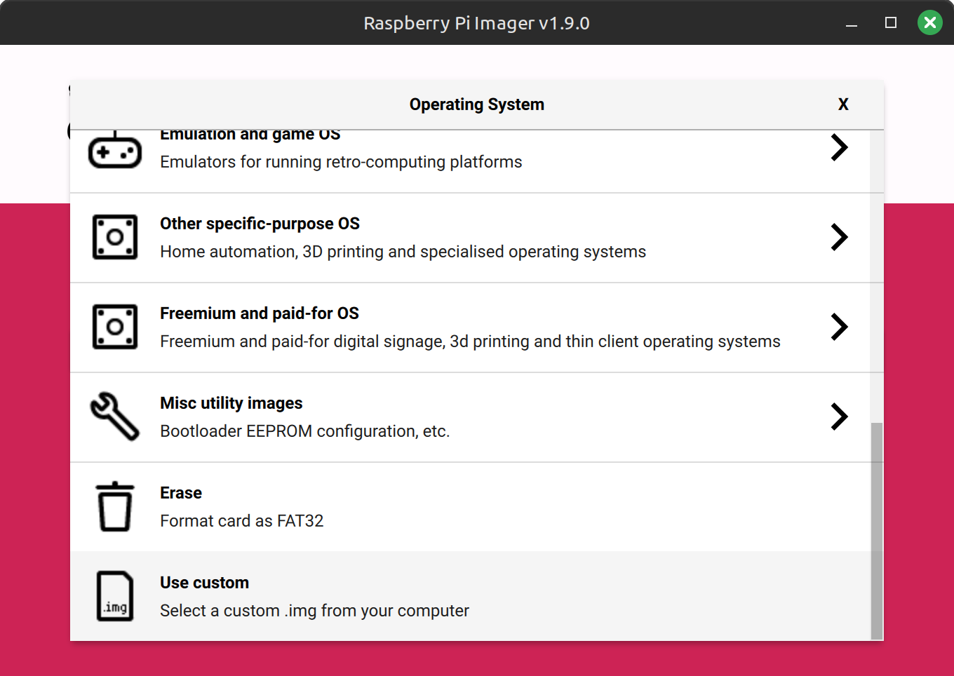

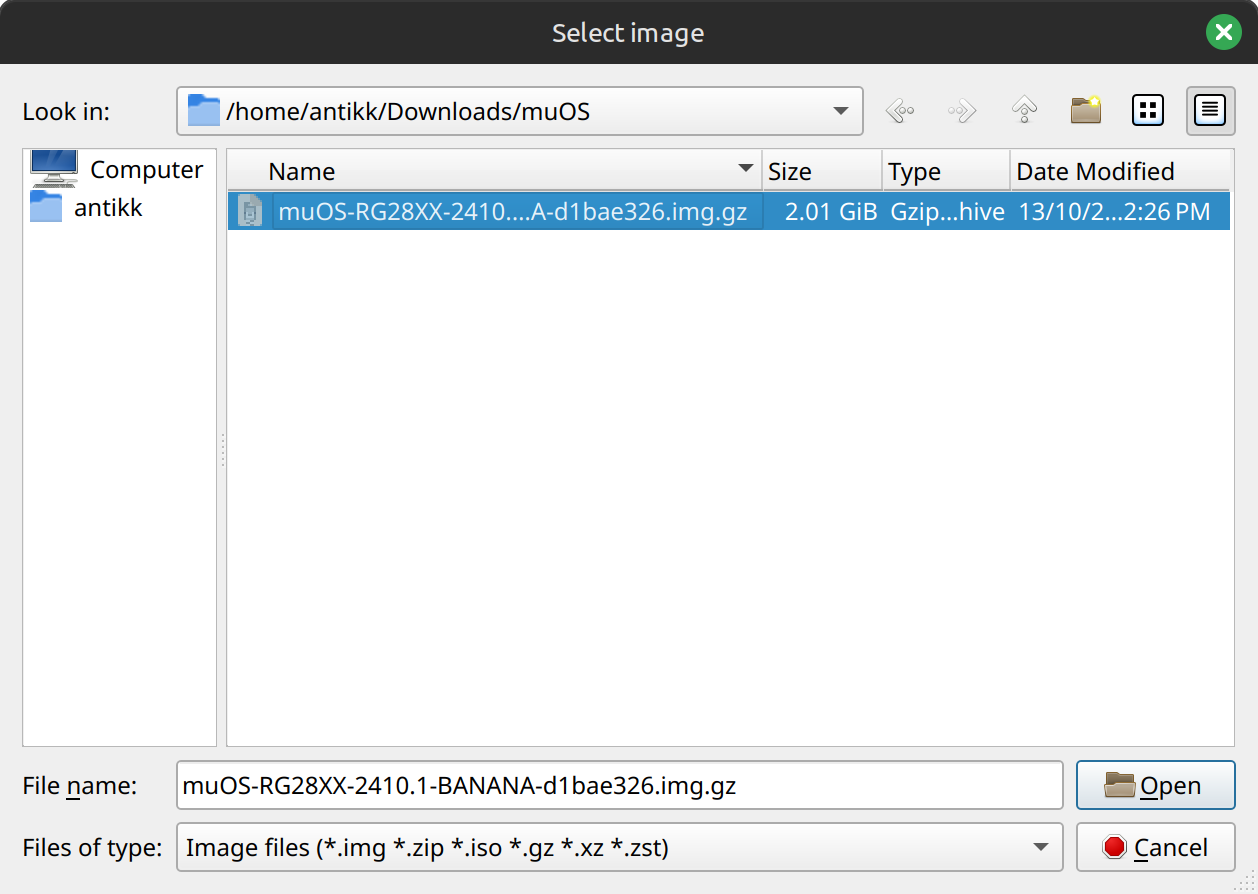

| Choose Use Custom OS | Select the MustardOS .img.gz |

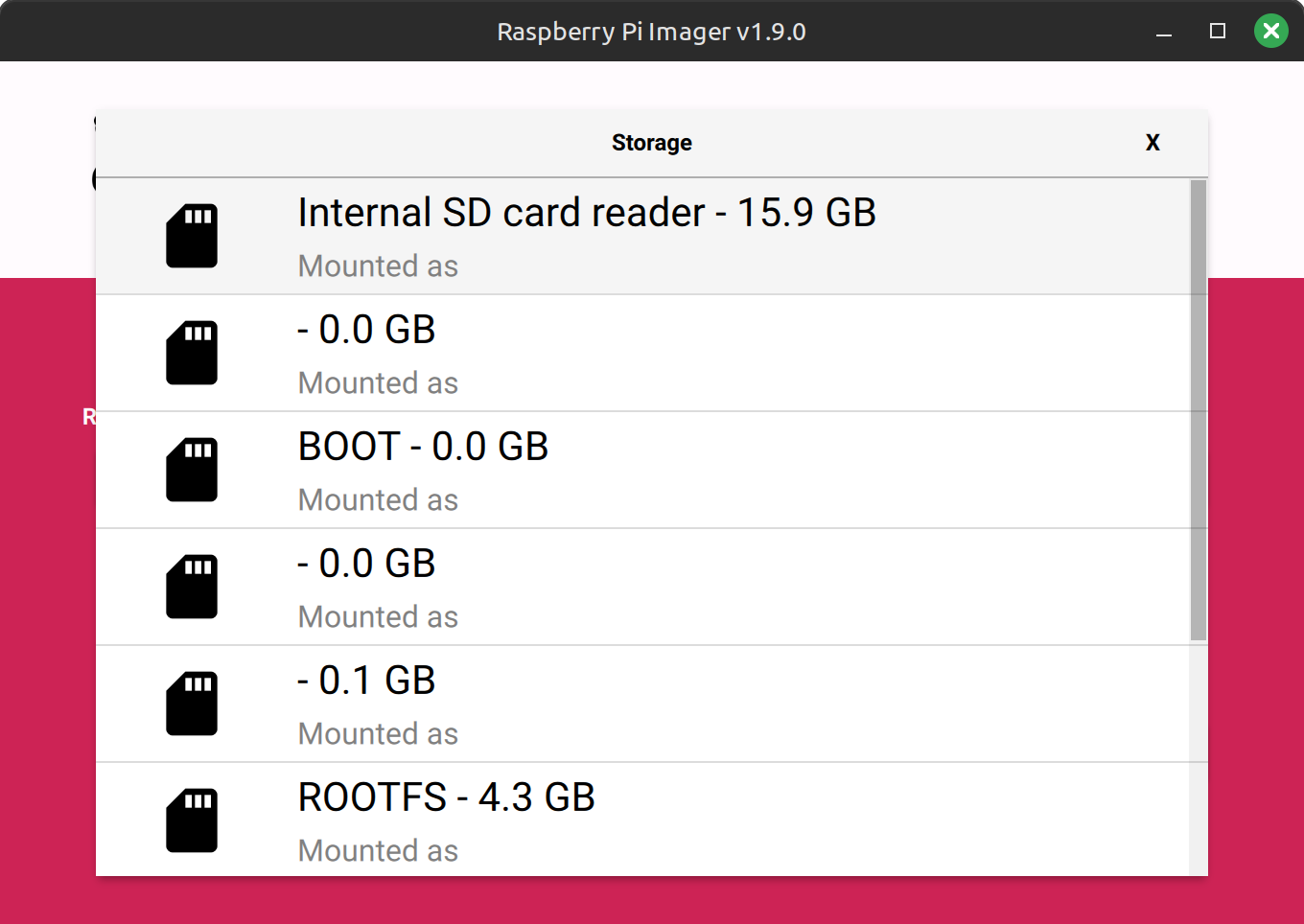

| Choose SD Card Reader | Click Next |

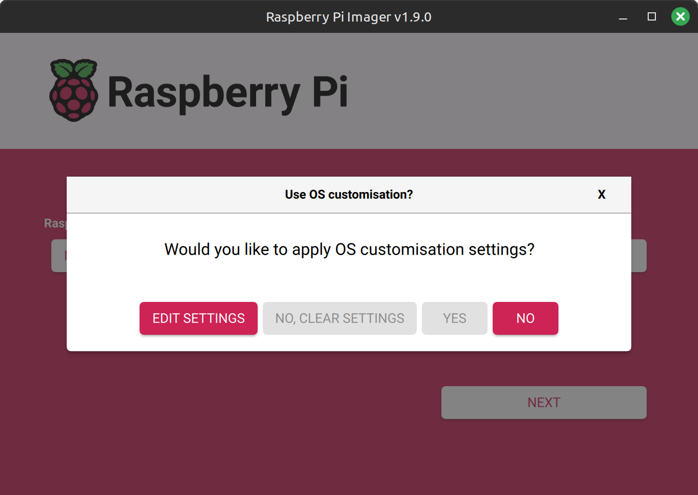

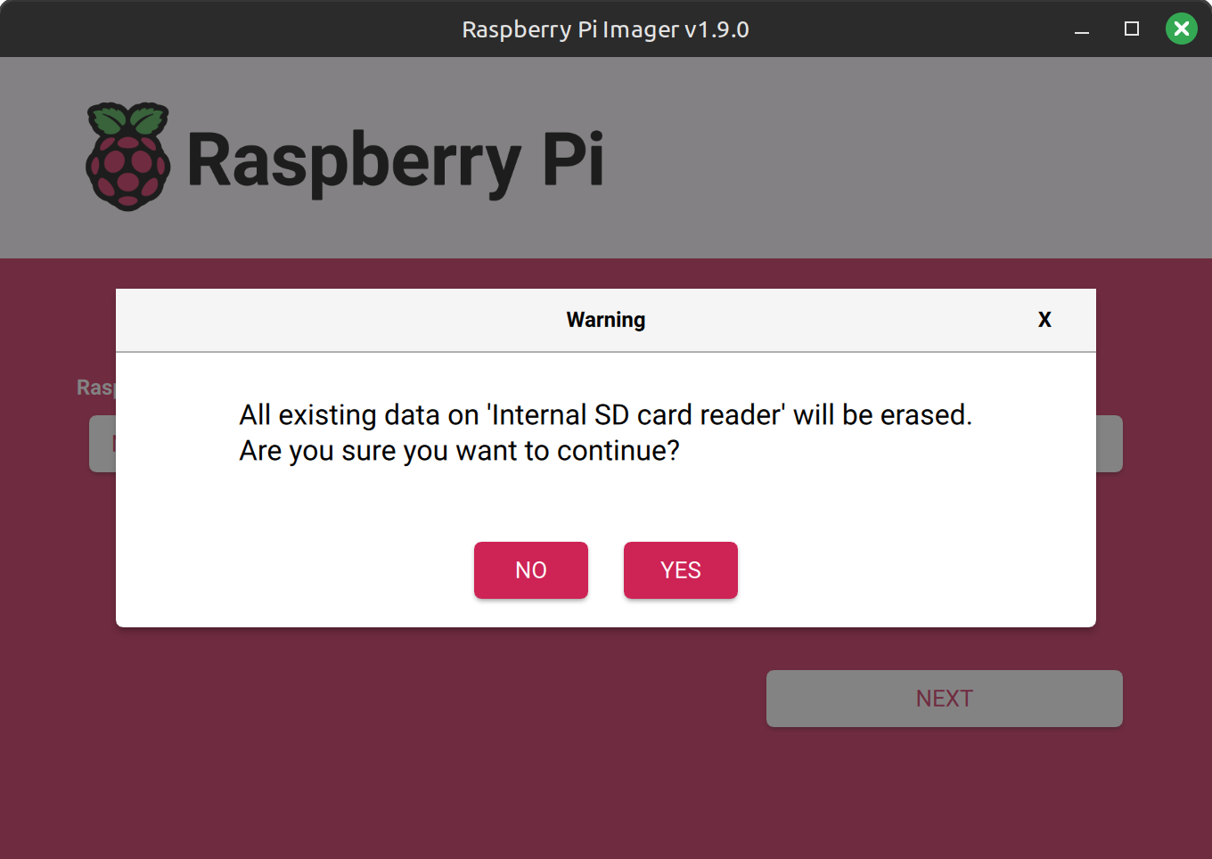

| No OS Customisation | Yes Erase SD Card |

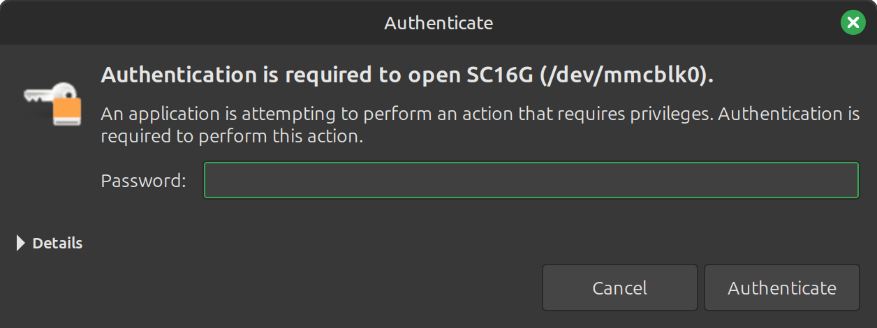

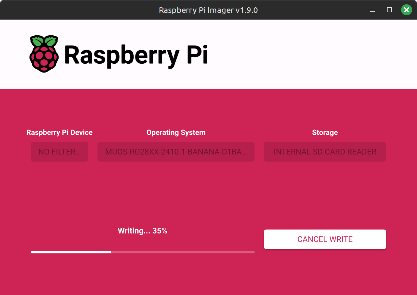

| Approve Elevation | Card begins Writing |

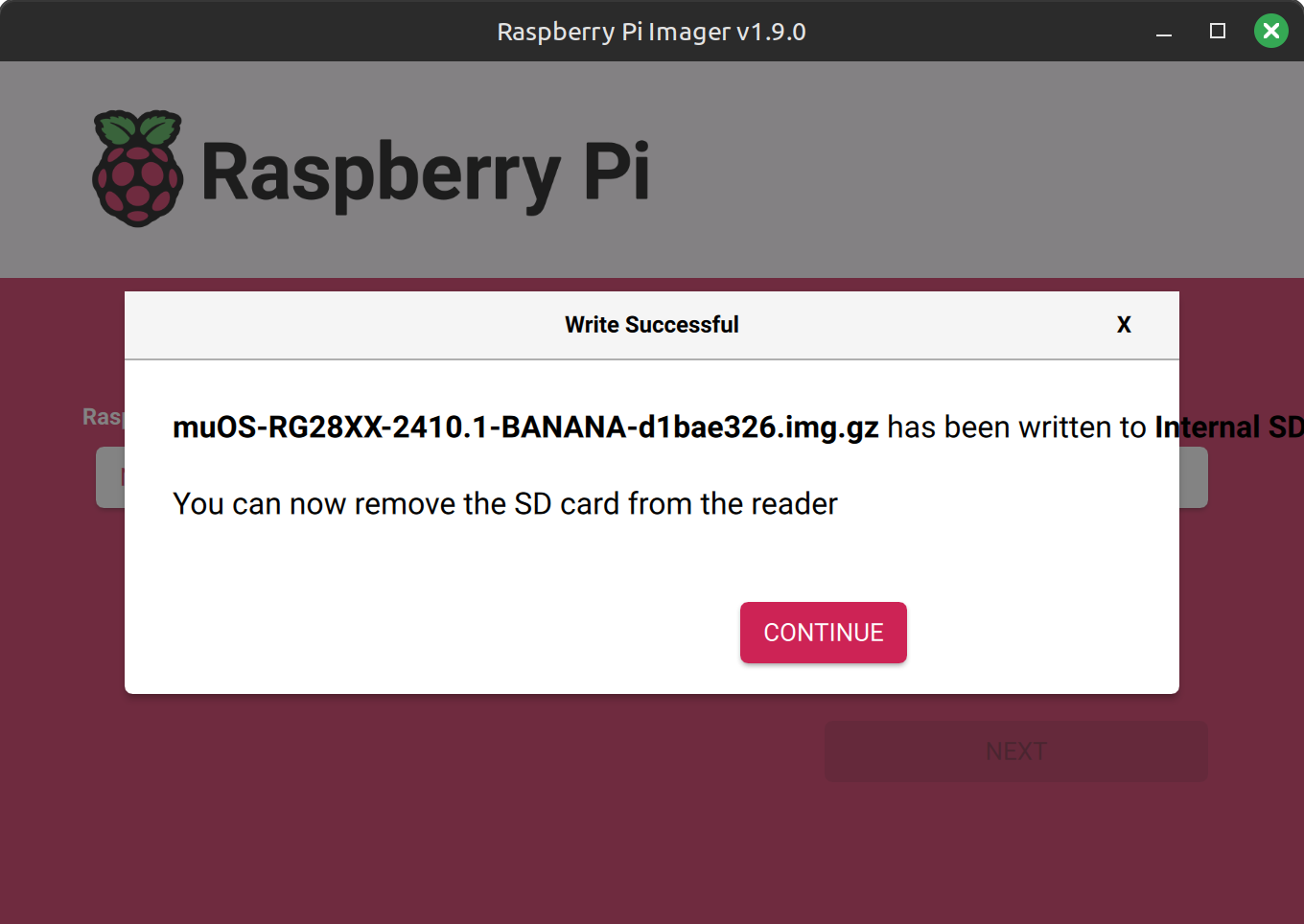

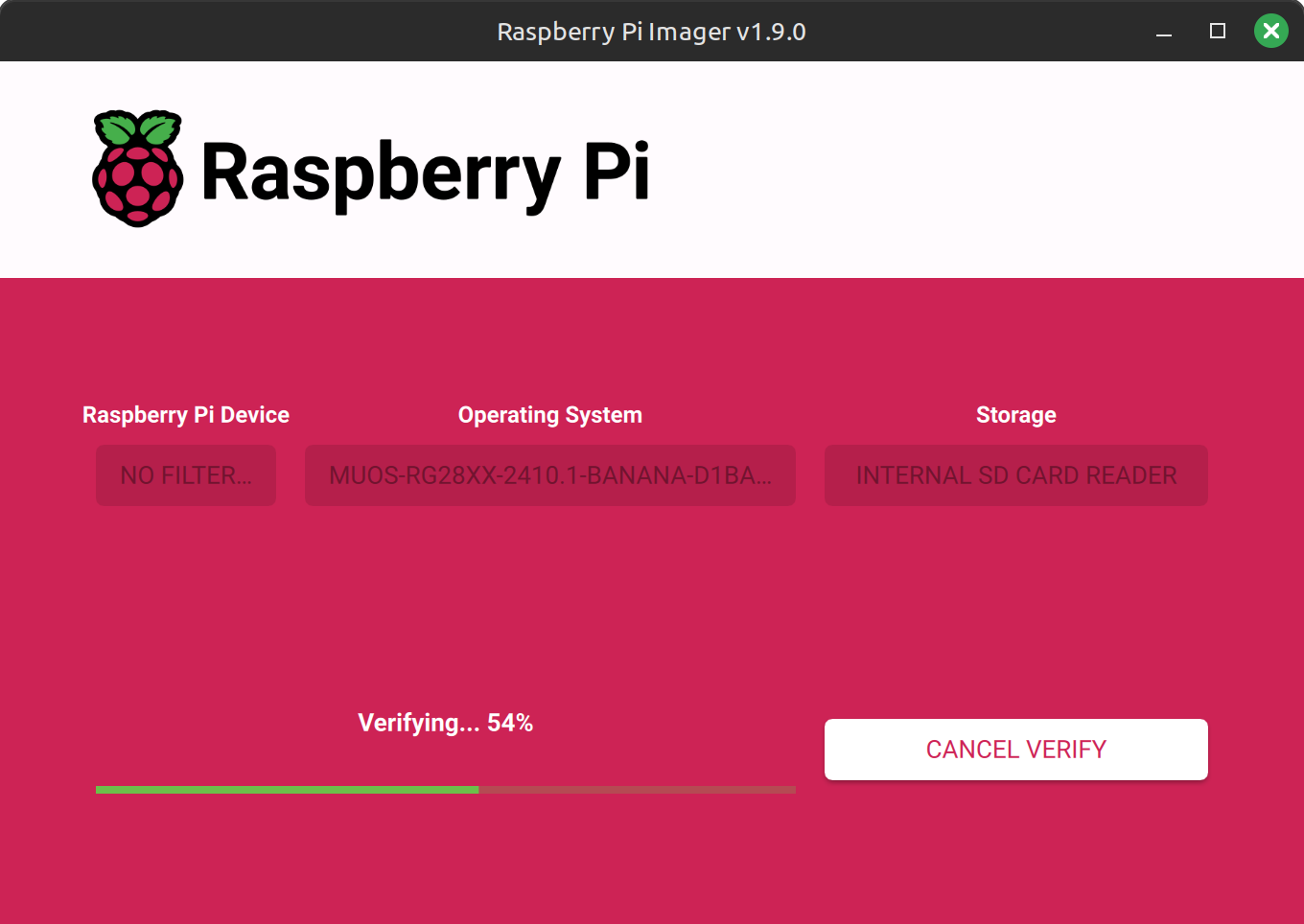

| Verify Begins | Eject and insert into console |
